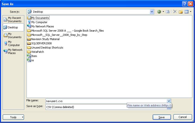

Save the filename in .cvs extension and Save as type = CVS(Comma delimited) then try againg
