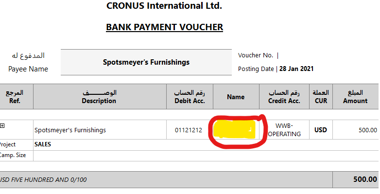

I am creating a new Layouts like the below:
I tried to get the Account Name (it should be getting from several tables based on the Account type)
Also, I need to add the Third and Fourth Dimensions.

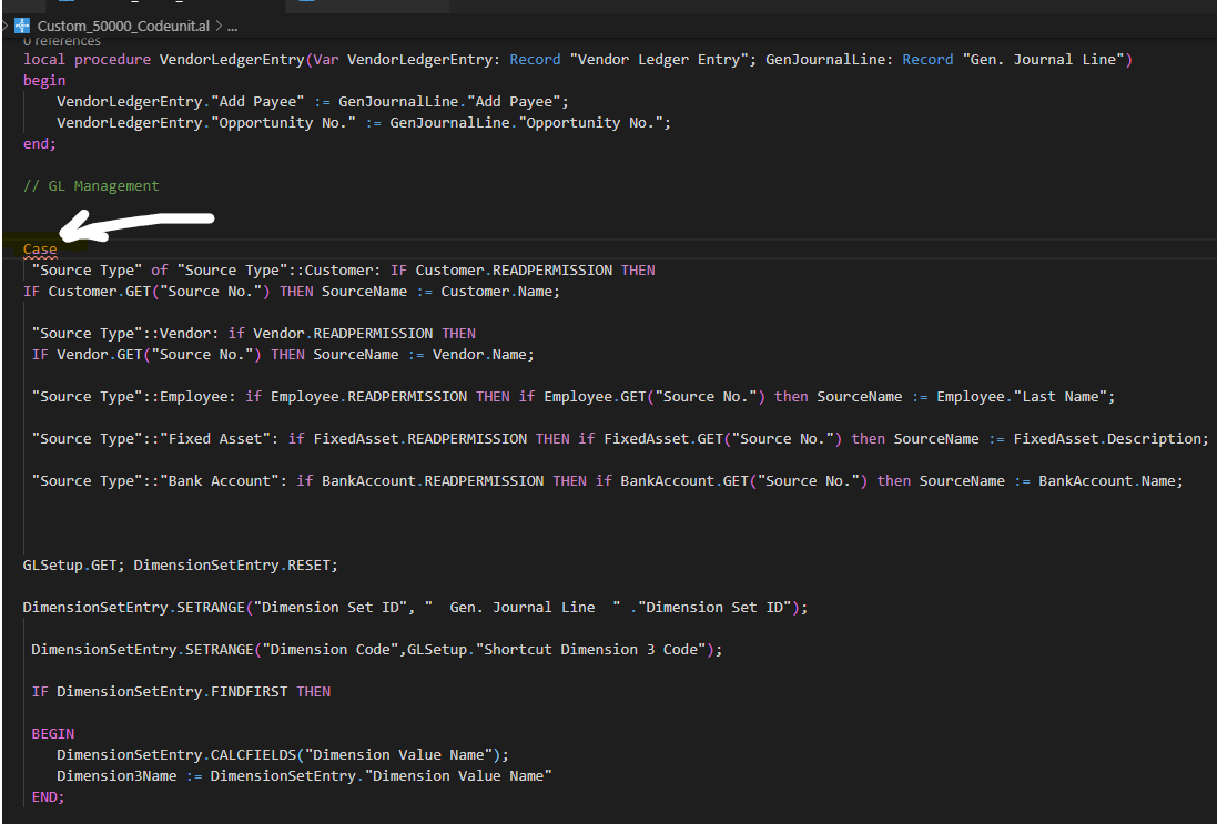

Dear [mention:c631451bdb884042a91594b4c8f131b8:e9ed411860ed4f2ba0265705b8793d05]
Thanks so much, but where I shall put this code, do I require to add in a Codeunit ?
I added in the Codeunit and I got this error
Add it on “OnAfterGetRecord” in the GL Entry Datatem

A CASE always need an
END;
This is basic development, so this is something you really should have found out by know. Also hovering over the word CASE should also tell you that the END is the problem.
