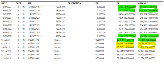

Hello everyone, I need some help for my report (again).
I want to get a table of data like this:
However, the table I get is different from what I want where the balance column is not calculated correctly. It should be the sum of the previous balance and the current amount. But this is the data that i get
as you can see the balance is not calculated as i want but there are also data like this
where some data balance is correct but after that the data is wrong.
This is how my dp class look like. Can you tell me what I should do to fix these problems? Thank you for your help.
