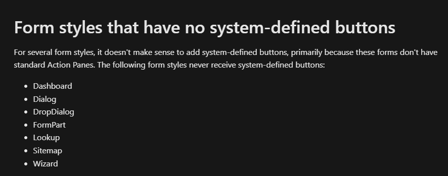

At first, I planned that after calling the system promptCopyDeliveryAddress(), I would set the default button to Cancel and press it to hide the standard dialog. Then I would extend it and write my custom dialog.
However, while researching, I found that selecting the buttons on that dialog is impossible, so I will try to find another solution.
System-defined buttons - Finance & Operations | Dynamics 365
Thanks for your feedback.
The documentation page is about a completely different thing, but anyway, I agree that your design wasn’t feasible.
