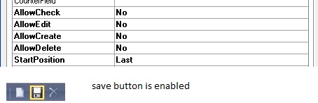

How to Disable save button in toolbar i Have already Changed data source properties allow edit to no but it is possible to edit the content and save it so i need to disable the save button i am beginner in AX…

Hai i already changed all data source edit to no but can able to edit the data and save the data … i have attached the screenshot

on each data source, check if there is a method called “Active”. if so, there may be code in there that is overriding your properties. The functions i am referring to are…
this.allowCreate(false);
this.allowEdit(false);
this.allowDelete(false); //false to disable delete, true to enable, same for all other attributes
Thanks Nathan its working fine
