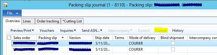

How to cancel Sales order Packing Slip (Project)
How i want to cancel SO packing slip(Project). Currently Button cancel is dimmed and i unable to click it.
is there any setup in parameter i need to tick?
The purpose why i want to cancel is because user wrongly select SO and post packing slip.

You cannot cancel a sales order packing slip that is been created from the item requirements.

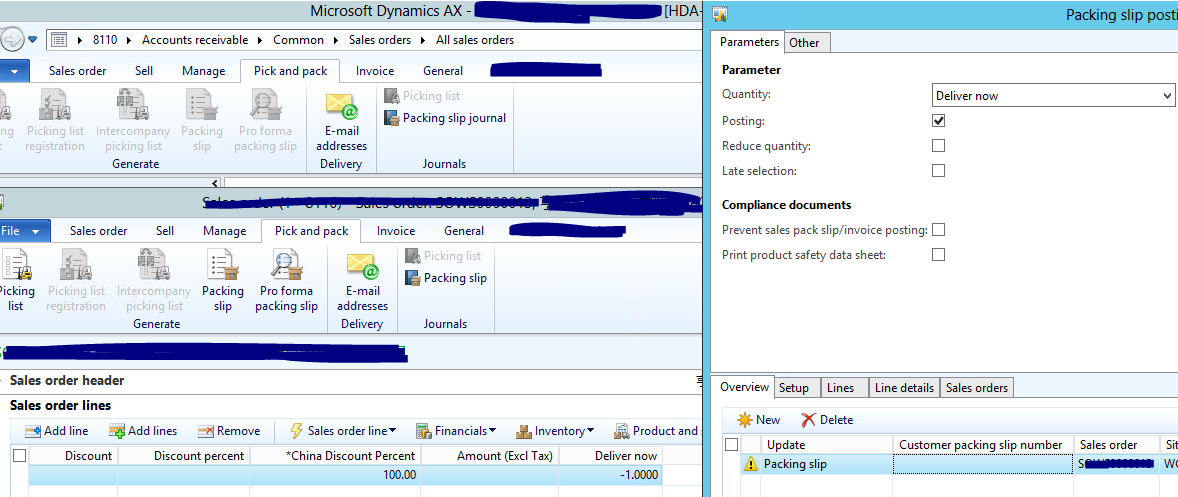

Try with a -ve delivery now.
Hi Kranthi,
Thanks for your response, i tried to use deliver now qty and update -1. But when i want to post packing slip using parameter “Receive now”. No line is insert in line tab.
I’m using AX 2012 R2, if not mistaken we cant post negative qty.
updating with -ve delivery reminder and posting the packing slip.
