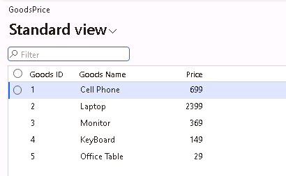

I have two tables: GoodsPrice table and SalesRecord table.
The GoodsPrice table looks like this.
1711612165370(1)
It has three fields: GoodsID, GoodsName and Price.
