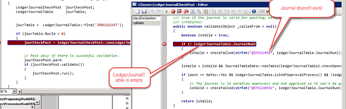

I am trying to post an invoice journal in (Accounts payable/Area page in journals/Invoices/Invoice journal) and here is the code that I am using in a job
static void testInvoiceJournalPosting(Args _args)
LedgerJournalCheckPost jourCheckPost;
LedgerJournalTable jourTable;
jourTable = LedgerJournalTable::find('JR04161547');
if (jourTable.RecId > 0)
jourCheckPost = ledgerJournalCheckPost::newLedgerJournalTable(jourTable,
NoYes::Yes,
NoYes::Yes);
// Post only if there is succesful validation.
if (jourCheckPost.validate())
jourCheckPost.run();
But it is failing at the jourCheckPost.validate() line of code. It seems like the LedgerJournalCheckPost doesn’t have a parm method that takes LedgerJournalTable to pass in. It only takes the journalid. Am I missing something to add in my code?
