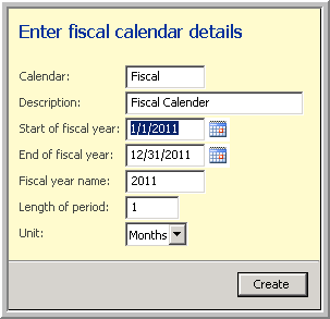

When you create new fiscal calendar, there itself we define the start of fiscal year. In the figure below, fiscal year is starting from 01/01/2011. I can’t create fiscal year prior to 2011.
Pranav…
Thanks Pranav,
As per the above picture after creating the Fiscal Calender 01/01/2011 … 12/31/2011. Now i need to create the New Fiscal year ,then when i click on the new fiscal year then system taking automatically as 01/01/2012…12/31/2012.
Is it correct ?
Yes. First fiscal year is created automatically. If you look closely on the picture above, basically we enter the data of first fiscal year in the calendar itself. Once the fiscal year is created for 2011, automatically system will take next year start date as 01/01/2012 and you won’t be able to create any year prior to 2011.
Pranav…
