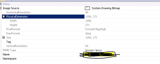

Hello Kwen,
The screenshot shows the properties of that Image in visual studio.
I cannot go to the actual image file from there

Right-click the image control and choose Image Properties. Then look at the value of Select the image source and source-specific fields below it.

I hope you saw the screenshot I have attached above.
I just see … in front of Image source which says System.Drawing .Bitmap
When I click on “…” it takes me to a folder location but the images are not there

Yes, I see your picture, but it shows a different thing than what I’m talking about. Please follow my instructions.

In that case, the image source (which you would have seen in the Image properties dialog) is Embedded. It’s not a reference to an external file (as if the image source was External); the image is embedded in the report itself.

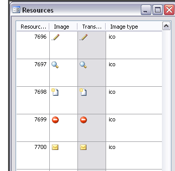

I did some search on embedded resources in AX 2012 and found form SysImageResources
Can I find those embedded images in SysImageResources form??
Does SysImageResources form contain both customized images or out-of-the-box images??

Embedded images is a feature of SQL Server Reporting Services (SSRS); it has nothing to do with resources in Dynamics AX. You can learn more about images in SSRS reports in the documentation (Images (Report Builder and SSRS)).
