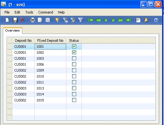

HI Jahan
canu send me the code how u have done the filter, even i have tried ur code but my filter is not working, can u post the code for the form lookup filter…
i have created the Form EZNDeposits
Here i have Deposit Number & FD Number, in this form same customer number with different FD Numbers
IN my Second form see below
Here in the Cust NoFInal field i need to get the look up from the First form Custno & FD no, while lookup is displaying it should filter the data, suppose if i pick the CUS001, under this how many fd are displaying i need to fetch that data…
can u tell me how to write the code like this senario,.
[:D]
Hi Ayesha,
I am new to AX, I am also stuck in same point Can you please send me the code.
