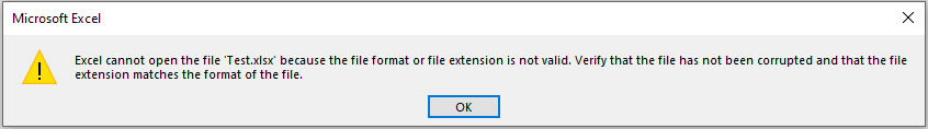

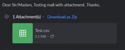

Issue: Unable to open the excel file from the mail attachment, getting the below error.
When the file format is PDF / CSV its working fine. Only facing issue when the file format is Excel facing the issue.
settings.fileFormat(SRSReportFileFormat::Excel);
In excel properties found few property changes
Looking for your valuable solutions, Thanks in advance.
