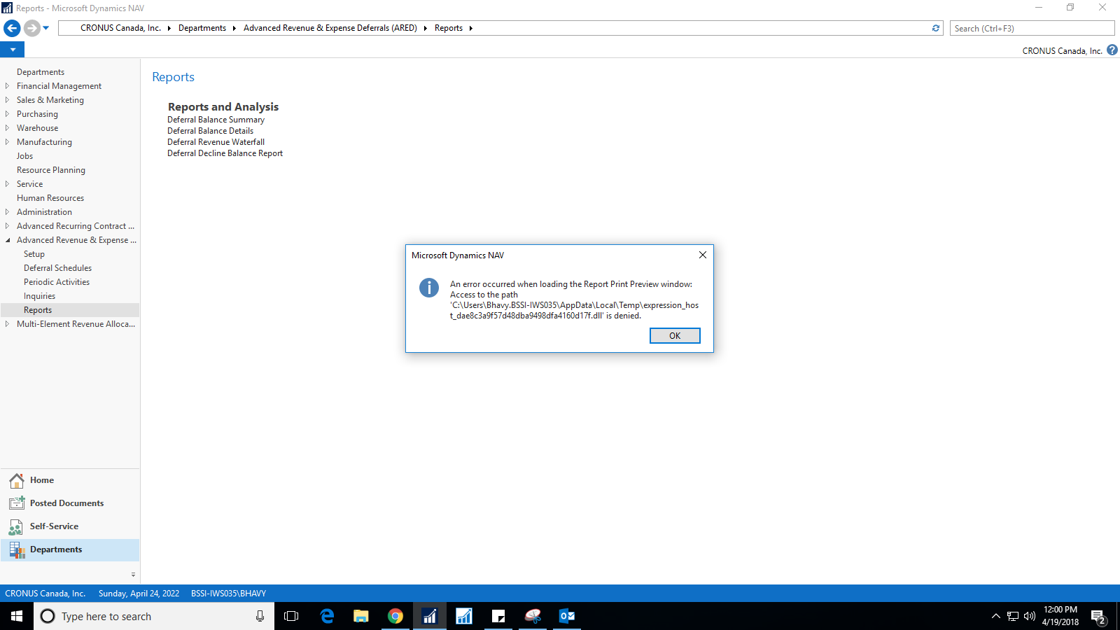

i am trying to preview an report. on my system which is having windows 8.1 and it is working fine. but one of the system which is having windows 10, it is giving error
When generating reports the system has to save the data in a temporary folder. The error message states clearly that you do not have write permission to that folder. My guess are that the user running the NAV client does not have full access to the computer? (Windows GROUP POLICIES are to strict/limitied).
If so, then an administrator has to change write permission to the folders - this is best done by uninstalling the client and then reinstall it.
The path in the error message shows that it’s user Bhavy’s folder it needs access to read and write in. Normally that happens per default, as it is the users own folders. You could check what permission the user account has on the Windows 8.1 machine and compare it to the permissions on the Windows 10 machine. If in a domain, then your group policies may have been setup differently.

i checked the permissions to that folder and he is administrator but still error message is coming. the strange thing is this, it is not coming every time but it is coming 3 times out of every 6-7 clicks.
If the Error persists… then the administrator permission is not correct. - as Erik stands below, any group policies on the machine? And what specificially NAV versions and buld.no. are you running ?
I can do it with remote access, you have to change the owner of the temp folder.
Go to Temp folder → Open properties of that folder—> Security TAB–> Click on Advance -->> locate change button near the owner —> serach for the user you are facing issues with & finally change the owner.
