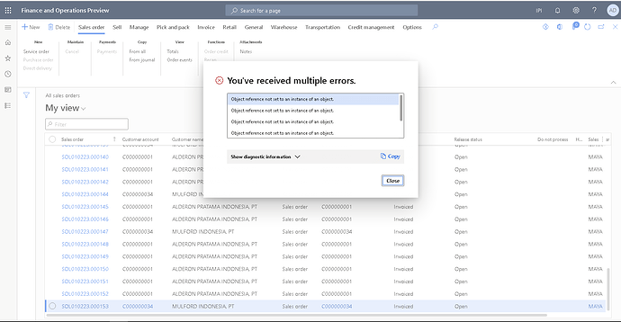

Hello, I am receiving multiple errors of Object reference not set to an instance of an object when I try to access the lookup for Customer account field as shown in the image below

But when I deploy the report, the parameter for the customer account gives an Object Reference error. But, this only happens for Customer account and even previous projects when I used CustAccount were affected. And when I try to access the menu with a customer account (Sales Order for example) the error occurs.

I am trying to print the report but when I choose the parameter for customer account I get the error shown in the my previous screenshoot. And when I try to access the sales order menu the same error occured as shown in the image below.
Oh but when I try to manually write the customer account in the parameter field, the report working fine according to the DP. So I think the problem is from the CustAccount but I’m not really sure why. Please help me because there are some report that I can’t access because they have a customer account. Thank you for your response
