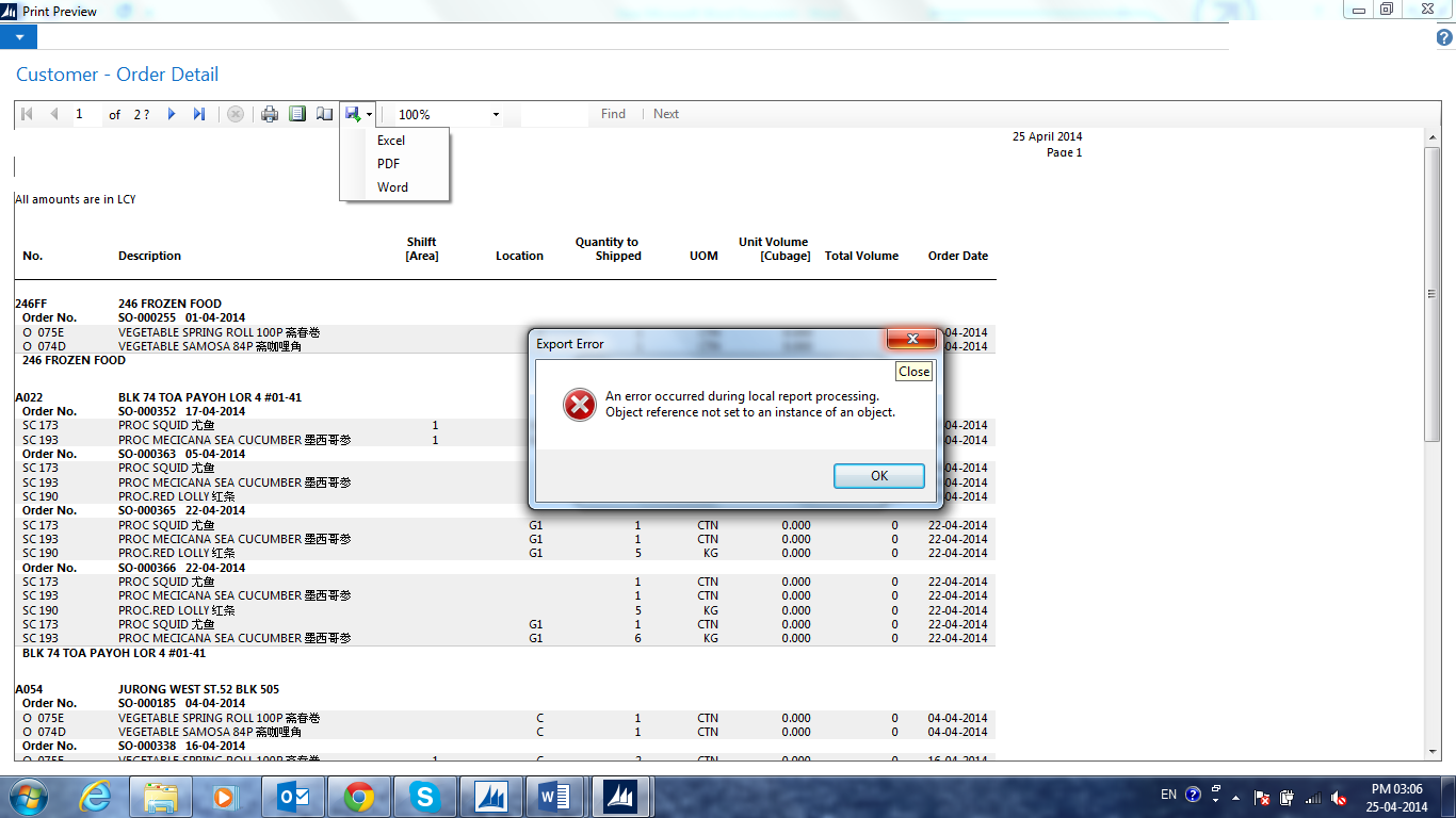

I am getting this error while creating PDF from this option, Has anyone ever face this error please help me why this error is coming.Also When i click print preview the same error comes.

Kindly check whether Adobe PDF is installed properly
As well henceforth mention Version of NAV…

Adobe reader is installed properly and i am using NAV 2013 R2 AUS version.

This error is coming only in one report. i am able to print preview other reports and convert then into PDF as well.
Can you please check if in the groups defined in the report you have some filters like this?
Fields!MyField.Value > " "
Because they have to be replaced with Cstr(Fields!MyField.Value) > " " to avoid this kind of errors.

I have checked the filter and it is correct as you specified in the example. What else can cause this error?
Other reasons can be Automation/DotNet interoperability used but not instantiated, can be your case?

I found the solution.
Somebody used the “ReportItems!MyField.Value” in the visibility expression of the Report Header textboxes, we can not use ReportItems keyword in the report header and footer. that is the reason for this error.

Hello Yes I am having the same problem and I do have several text boxes referring to ReportItems in the expression, do I remove them all, what If I do want text to appear there?
You need to use GetData/SetData functions: http://msdn.microsoft.com/en-us/library/dd301162(v=nav.70).aspx
