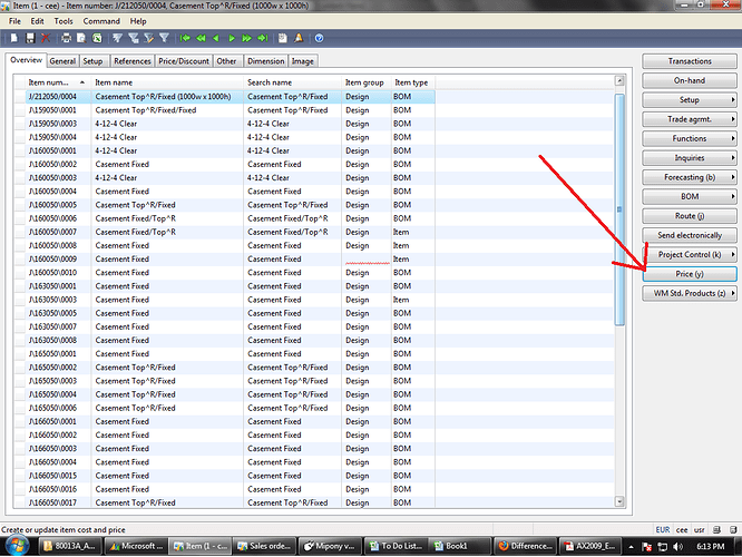

1st if i calculate price & cost form iteamDeatils form it will fill bothprice & cost of item according to route & BOM line. and then if i add this item as salesLine the SalesPrice of this item is added to unit Price in SalesOrderLine.
2nd if now after adding this item in salesLine if i do bom calculation as shown below its unit price gets changed!! i wonder about this thing, how this both calculation differs…???
