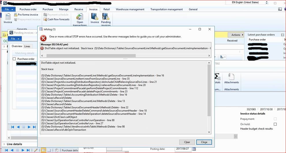

The pending invoices are not visible in the AP>Enquires>History>Invoice history and Matching tables. But it is present in the VendInvoiceInfoTable.
I tried deleting it from the table I still get the same error. I can able to delete it by writing a job using dodelete(), but i want a permanent solution for this.

What is the value of this.SourceRelationType ?
dictTable = new DictTable(this.SourceRelationType);
I tired to identify the route cause but couldn’t able achieve where things are going wrong. "this.SourceRelationType"is a field . SourceRelationType is a field from sourceDocumentLine table which contains the tableID value.
Yes its a field. I was asking what value you are getting in that field while debugging. (as it is unable to create the DictTable object based on that value)
It actually runs 4 times and for the first 3 times I am getting values of vendInvoiceInfo table(twice) and purchorderInvoice table once the 4th time I am getting a null value
On checking in sourceDocumentLine table find method returns a null value . But the passed recId value is present in the table but still it returns null value
