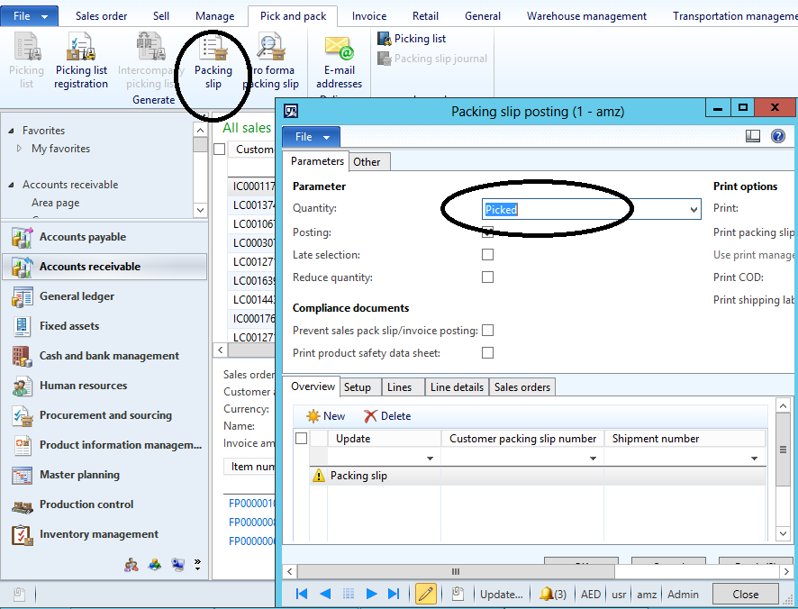

Clicking packing slip from sales orders shows picked but when clicking the sales order and from inside the order if we clicked packing slip it gives all.
Is it possible to have the same behavouir of this on to the sales order packing list.

What exactly is the difference between “clicking packing slip from sales orders” and “clicking the sales order and from inside the order if we clicked packing slip”?
That’s controlled by the recommendedSpecQty method on the SalesParameters table. It’s different based on the type of transaction that’s happening.
