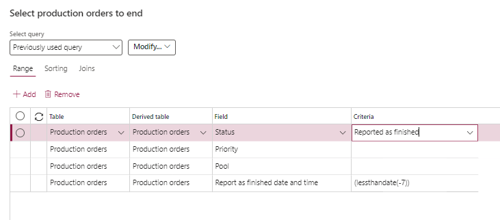

Can you please tell me which form did you add the range to and provide a screenshot of your query ranges (Options > Advanced filter or sort)?
Production Control > Periodic Tasks > Production order status update > End
Then in the “select” query
but it looks like the actual capitalization of the function matters…is that correct? It should be (lessThanDate(-7))?
