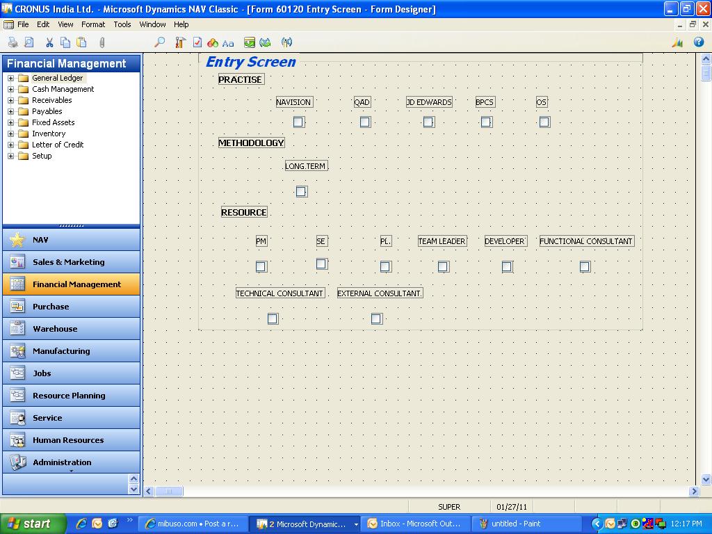

My fields are decimal fields, so cant use const i think!..And i will attach my snap here…in methodylogy there are serveral, but i have kept only 1 here, so when i click the methodology and the resource! only the resurces i selected should appear in the form…
I’m a bit confused with the screenshot you’ve attached. What are you trying to EXACTLY?
a) Are you trying to Filter Resources based on Methodology, Practice etc?
b) Are you trying to get the filters first and then display a form based on the selection?
c) What and where is the Decimal fields you’re talking about?
b) For the Practice Nav i have a form which has all the values…'m gonna apply the filter on that and display accordingly.
c) the PM checkbox in the resources, its an decimal field in my table which is calculated partly codes and partly by flowfilter. thats what i was speaking about.
i no that[:)], if you see my snap shot there i think you will understand more…i have practise,method,resource…so i want to filter as
Prac : Nav
Method : LongTeam
Resource : PM SE PL
this entry form consist of all the details of an compamy in it…but a Nav user can access only Nav details and Os users Os details…till now are you clear?
2nd part…According to your position in the company you can access these details…not all can access all details right? some can be very confidential.
So in order to prevent that, 'm creating an entry screen which has loads of filter…
So…when you select Nav, all the methods and Resources will be of NAV…the name wont change, only the forms opening will.
So lets call them as practise here…but a person(say myself) is working on NAV! so i can access only NAV details. but the company has all the details of all the practise!
clear till now?
now…when i select NAV in the Practise…All the method & resources opening will be of NAV details…
But Not all person can access all datas even in NAV…I am an Technical person, so i can access only technical details! thats is where Methodology cames…then i want to view only particular datas in the methodology! so comes the Resouces!

yea…thats what i want…And B and C are values of which name field? because a checkbox can have only 1 name field right …then which is it in this B or C?
'm keeping an button called SHOW…so after selecting all the options ,when i press show it will show accordingly…otherwise the user will not know when the form opens…
so the entry screen now will have all the checkboxes… like this…
This is clearly an example of NOT KNOWING WHAT YOU ARE TRYING TO DO. Had I been developing such a Form, I would’ve known what buttons will appear at what time.
It is very important to ‘think it through’ before you start. If you want:
a) Methodology, Resource buttons to appear after a User clicks Practice, then you’ve to write code in the CheckBoxes of Practice.
b) If you want to show all the buttons for the user selection, and then show him the main form at once, write your code in the SHOW button.
