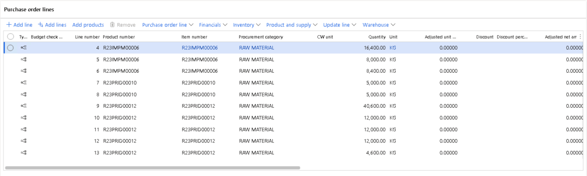

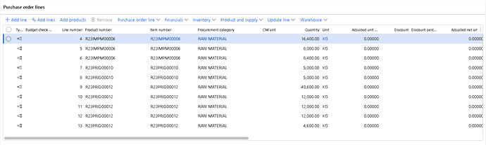

  1. Example:
    Example 1
Example 2
  • PO with multiple items in a single PO without delivery schedules.
  • I’ve tried different approach and this issue solved, but the issue persists when there are multiple items with delivery schedules.

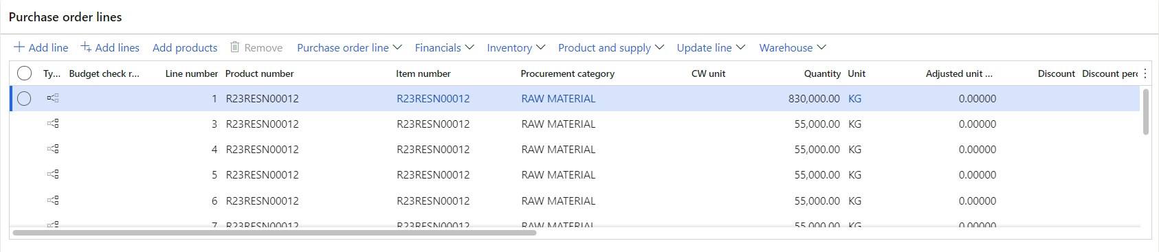

    Example 3:
  • PO with multiple items with delivery schedules.
  • First receipt
  • Subsequent receipt
  • If i use the this code: (see full code below)
                deliveredQty = 0;
                while select sum(Qty) from VendPackingSlipTran2
                join VendPackingSlipVersio2
                where VendPackingSlipTran2.ItemId == tmpBPB.ItemId
                && VendPackingSlipVersio2.VendPackingSlipJour == VendPackingSlipTran2.VendPackingSlipJour
                && VendPackingSlipTran2.OrigPurchid == PurchID
                && VendPackingSlipVersio2.InternalPackingSlipId <= PurchInternalPackingSlipID
                    deliveredQty = VendPackingSlipTran2.Qty;
                    tmpBPB.QtyOS = purchLine.PurchQty - deliveredQty;
                    tmpBPB.update();
                    deliveredQty += VendPackingSlipTran2.Qty;
i will get this, the receipt has the last qty for every line
