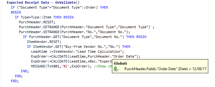

Thanks you manjusree.
I write code in page (ID 54- Purchase Order Subform).
When change code then Error “The type NavOption is unknown.”
And i debug then Document Type for Purchase Header is : “Quote”
Please help me. Thanks so much.
Hi,
Sorry, did not notice, there was an issue with the GET statement in my code. Please change it to
IF PurchHeader.GET(“Document Type”,“Document No.”) THEN BEGIN
Thanks you mạnusree

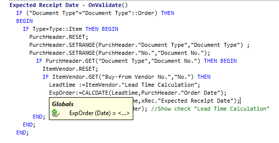

After change “IF PurchHeader.GET(“Document Type”,“Document No.”) THEN BEGIN” then Ok.
But variable ExpOrder:=’’ . I tried as failed.
Leadtime =10D
PurchHeader.“Order Date”=‘12/08/2017’
But ExpOrder:=’’ It does not calculate the ExpOrder value.
Hi,
Not sure why are you adding XRec.“Expected Receipt Date”. Just add
ExpOrder:=CALCDATE(Leadtime, PurchHeader.“Order Date”);
ERROR(FORMAT(ExpOrder));
This will work.
