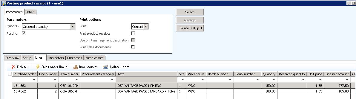

This view shows when I first get into register my first quantity. The next screen shot shows the error I get when I click the update lines button when I try and register the next lot.

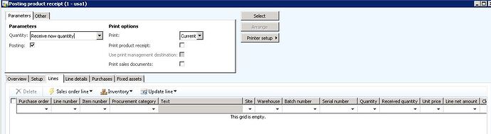

Thanks for the reply. When I change to Receive Now Quantity, AX takes away the lines I can receive. Is there another setting I need to change? See screen shots below:

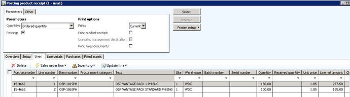

This is when I have the Parameter set to: Ordered Quantity. I can receive the quantity just fine.
But… when I change the Parameters to Receive Now Quantity, the receiving screen is blank, as shown below.
What needs to be changed so I can receive under the parameter of Receive Now Quantity?
