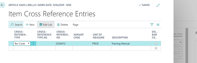

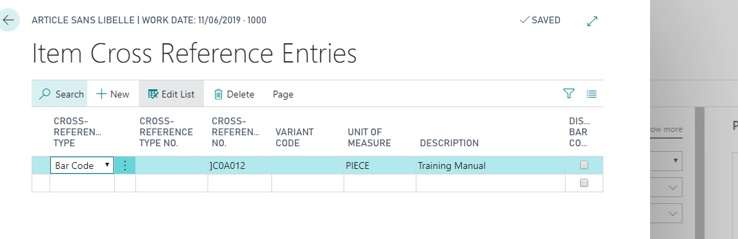

For a shop, it’s better to use bar code cross references.

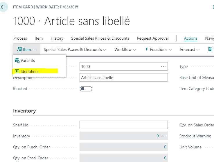

Item identifiers are only required for ADCS in warehouse: https://docs.microsoft.com/en-gb/dynamics-nav-app/warehouse-use-automated-data-capture-systems-adcs
This information is very specific for this functional area, while cross reference codes will be carried over to all your sales and purchase documents.
