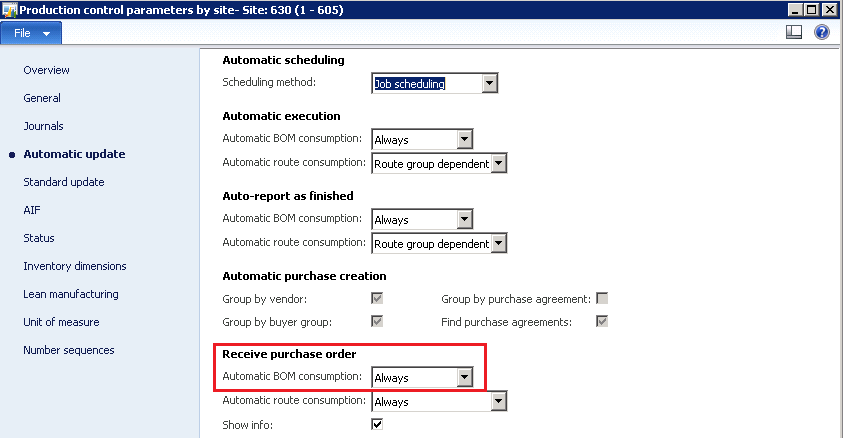

Is there any standard setup is available in AX 2012 by which,automatically picking list is posted for the item at the time when Posting the Product receipt ?
I got one field but want to confirm same,
The setup path is : Production control parameters > Setup > Automatic update > Receive Purchase order > Automatic BOM Consumption.

I need to know the setup in Production control parameter > Setup > Production control parameters by site > Automatic update > Receive Purchase order (attached screenshot).
Can I have the detailed functionality of that setup ? In which scenarios respective setup is to be used with sample example?
