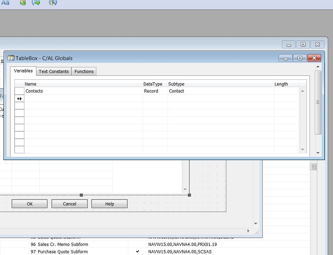

When your From is open, from View choose C/AL Globals and create a new varibale called Contacts with type of Record and Subtype of Contact table.
