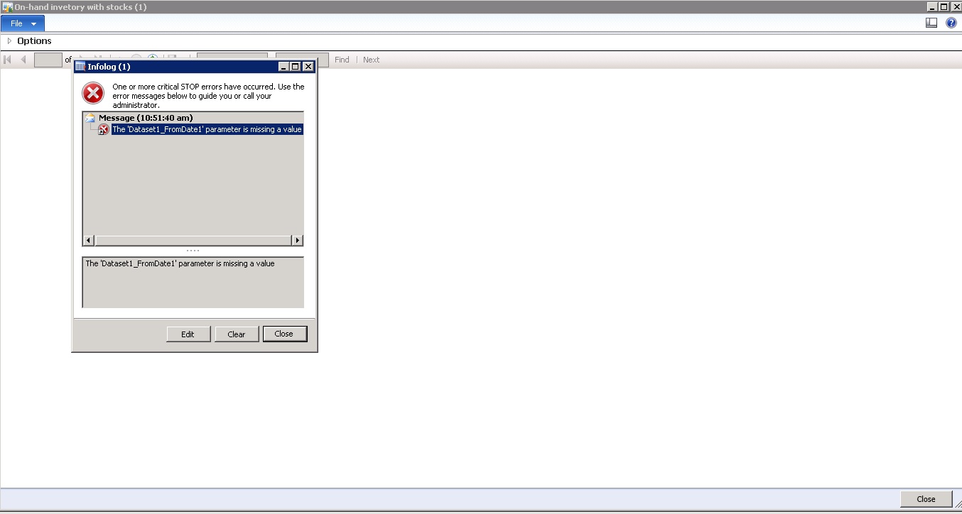

The 'Dataset1_FromDate' parameter is missing a value. Using Inventsum 'ModifiedDate'

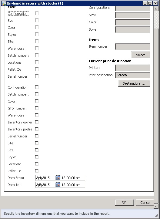

Hi martin…
Here’s the screen shot:
then Here’s my ProcessReport Code:

I don’t know what is wrong on my code? …
because I’m using that kind of parameter in other report I create and it works fine…
this is the first time I encounter this error…
