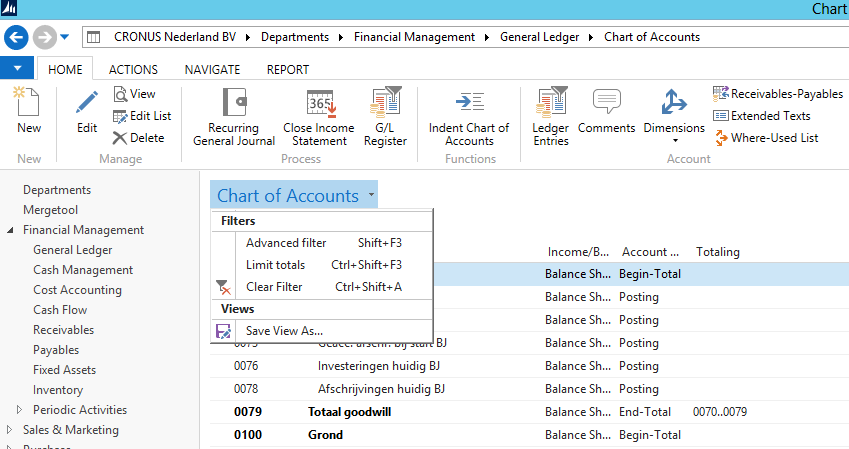

When I start my navision, I click Chart of Accounts from left navigation pane under Role Center and it opens up. Now how can I filter the chart of accounts for different dates, for example, from 010713…311213 date.
In the Add Filter, I don’t see the option for date.
Thank you for your help.
Regards [:)]
You have to set it in Limit Totals
See below picture to know how to add limit totals

Thank you for your reply mate. It works.
